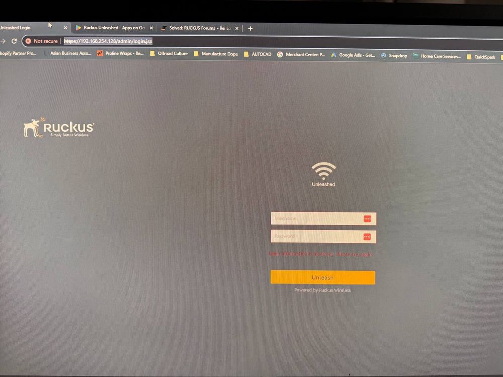

12-11-2023 07:44 PM
Need help on logging in on Access Point! I do not know the username and password I used before.

12-12-2023 05:32 AM
Hi @jandres_03
Hope you are doing well
As this case is raised by @Hidi1982 which is now closed.
To avoid confusion with posts, you can create your own post with the problem you're facing and a detailed description of the network issue and what you've done so that we can guide you properly.
