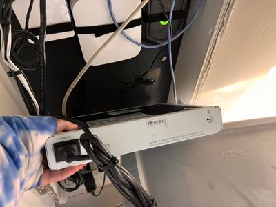

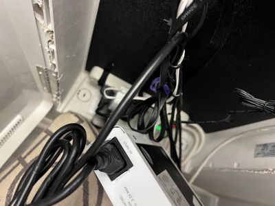

I purchased the cables needed and when I arrived back home the switch had no power. I have taken more pictures to show you.
