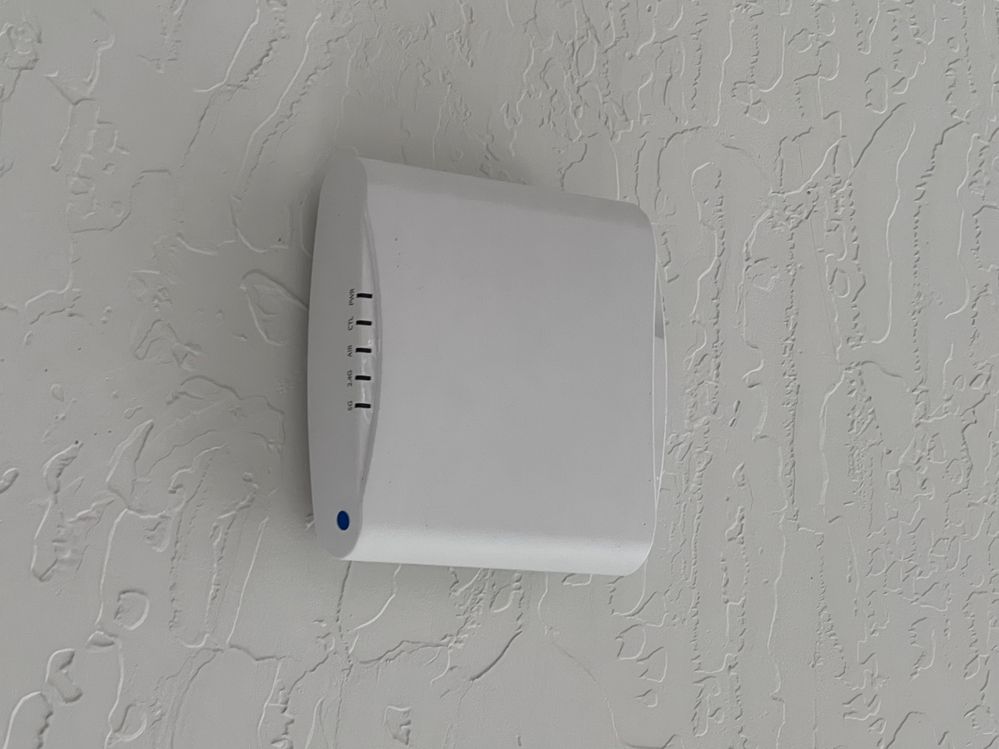

My r510 is not receiving PoE (power over ethernet) after power outage, but if I connect it to a 12v converter it would function normally. What would be the next steps?
I bought a Cable tester and the ethernet cable is in good shape. I also tried a different switch (netgear) and it would be the same issue, only functioning over 12v.

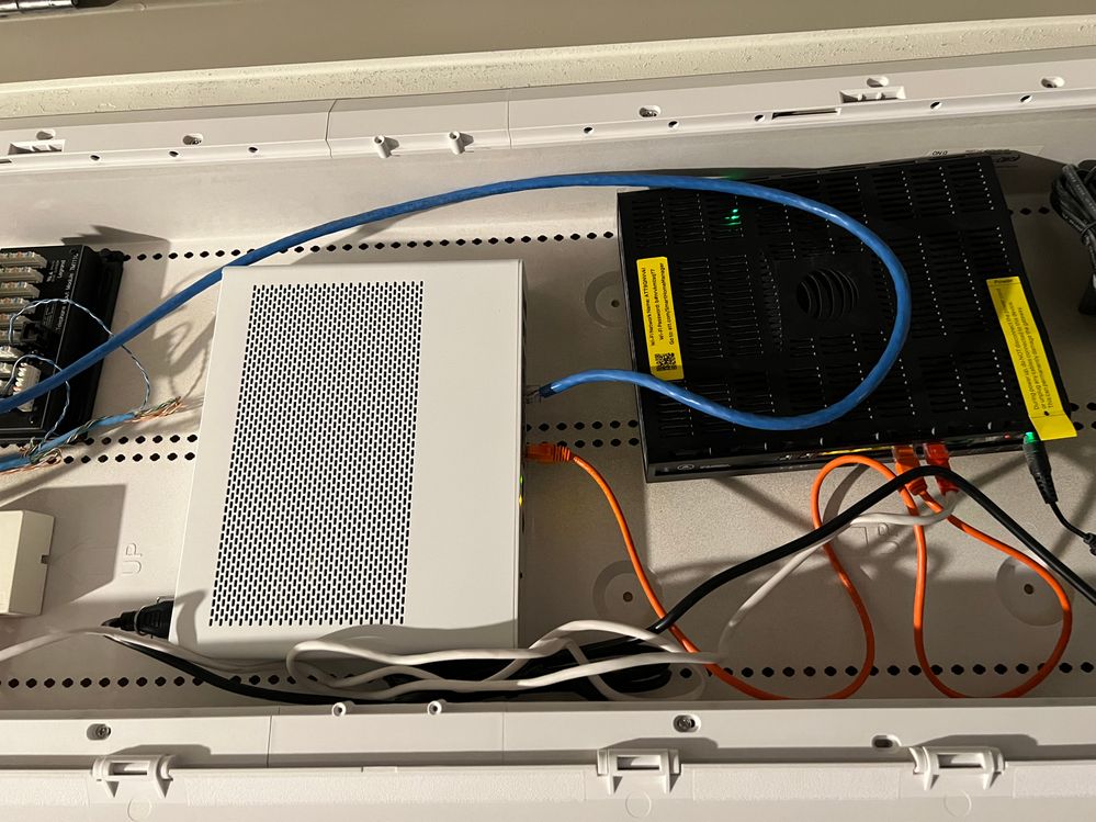

Please help us with pictures of your ICX-7150-C12P Switch showing the status of the lights.

1. Please see the lights in the pictures attached.
2. Ethernet is connected to one of those port.
3. The device is connected to a well-known power source.
4. Only 1 AP is connected, see pictures.
Also, while I connect the AP to power 12v, I am able to make it work, the only problem is PoE. Also it works with 12v with an NETGEAR link.

As you mentioned and I can see from the picture you shared, there is an amber light on the "SYST" and a green light on the "PWR" in the section above the USB/ethernet ports. Meaning the Switch is stuck in the boot mode.
Basically, due to the power outage/ power spike, the switch went to a state that we called (boot mode) that is not able to boot up properly.
And it does not mean it’s broken or needs to be replaced in some cases.
