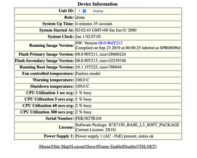

I changed the boot sequence to Primary Flash and reloaded the Switch but I still see SPR in the Running Image Version.
