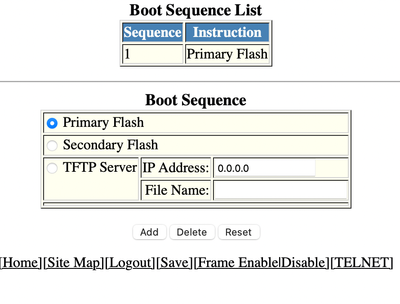

Hi Imran.
I changed the boot sequence to Primary Flash and reloaded the Switch but I still see SPR in the Running Image Version.

Hi @Rayoub
Thank you for the response and update.
Please follow the process once again as per the steps below:
Step-by-step screenshots below:
