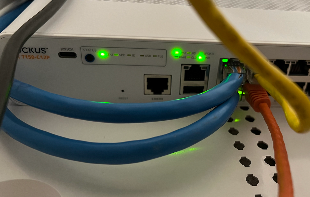

Rayoub
thank you Imran after about 15 reset I have these status lights. Please I would like to help to prevent this from happening again. I only have access to MacBook. Screenshot 2023-09-14 at 8.20.39 PM.png
Hi @Rayoub
Great!!! Good to know that Switch is back to its normal state.
To avoid this issue in the future, we must Upgrade your RUCKUS ICX-7150-C12P Switch to the latest stable version.

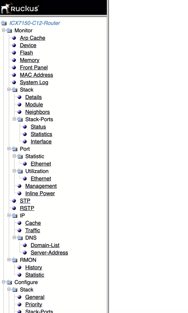

Rayoub
Is there any way to do this through the web portal? Thank you!Screenshot 2023-10-23 at 4.26.26 PM.png
