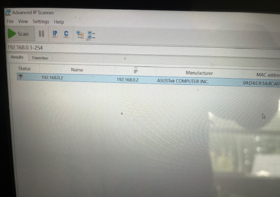

I downloaded and ran the Advanced IP Scanner but it's only finding my ASUS router. I was connected to the Ruckus network when running the scan so the network is broadcasting (but doesn't have internet access). I ran the scan with IP range 192.68.0.1-254 (matching the instructional link you provided). How do I get the Ruckus Switch to show up in the scan?
08-03-2025 10:11 AM
Here is a photo of the scan parameters and results.
08-03-2025 10:28 AM

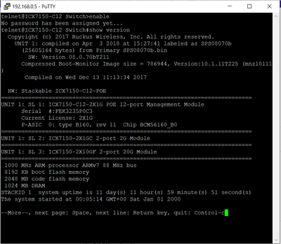

OK, so I moved downstairs and reconnected to the Ruckus network (via the non-master AP) and it currently has internet access. I was able to locate the switch IP and access through Putty via the telnet option. I entered "enable" and "show version" and below is the result. I'm no longer able to enter any other commands at this stage (nothing happens when I try to type "show flash") - what is the next step?

Hello @wehttam77 ,
I understand that your Switch is on older version, which is 08070b.
We suggest upgrading your switch to the latest stable version to avoid this issue in the future.
Please follow the below RUCKUS Lennar Knowledge base self-help article which will help you to upgrade the switch to the recommended version.
Please follow the process explained in the article and let me know if you have any queries in this regard.
