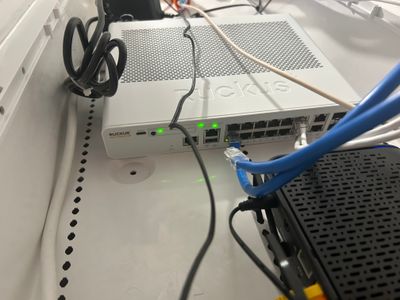

2. On your switch while it's plugged into the outlet, do you see any lights on? (Amber or green) Please let us know which lights are on. (Please refer to the below picture and share a picture of the same, showing the light status and the FULL Switch panel cable connections to the Switch ports)

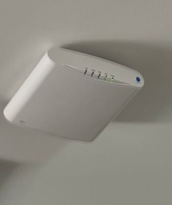

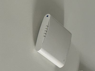

4. May I know how many Access Points are connected to the Switch? Could you please let me know the light status on the Access Points? Any of these lights are on (Please refer to the below picture and share a picture of the same)

2. See attached picture. Getting green status/system/power LEDs. I have the 2nd floor AP plugged into port 2, getting steady green LED. 1st floor AP is unplugged.

4. See attached picture. Only the second floor AP is plugged in currently, which was previously the master AP. It’s receiving power, getting green solid CTL light and slow blinking green power light.
*note: when the 1st floor AP is plugged in and 2nd floor is not, the 1st floor AP gets alternating slow blinking green LEDs on power, CTL, and Air indicators.
