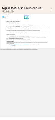

So we did the reboot on the switch and router and connected to Ruckus Unleashed Network but we get no internet connection error and we see this below error from ATT and like I said we are Xfinity customer and not ATT, we checked there is no ATT device in this house
We rebooted Switch and Router and when connected to Ruckus Unleashed Network we get No internet connection error and and we are asked to sign in to ATT see below screenshot, and like I said we are not ATT customer, we checked there are no ATT device connected in the house. Also just to let you know when we connected our phone and Laptop to Ruckus Unleashed Network Light on the AP turned green on 5G

Above steps are also done but when we connect to the wifi we are routed to ATT error page, whereas we are not ATT customer we are Xfinity, previous owners were ATT customers, could you please check
