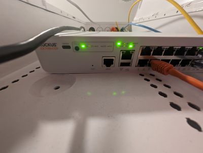

I have frontier internet in a lennar home that came with the switch. The frontier internet connects from the modem to the lennar switch. I previously did not have any issues but after having to reset the breaker, My internet from the ruckus switch keeps disconnecting after 5-10 minutes or is very slow.
  • I've included a picture of the switch as well as the ?extender, I have two of them. I don't have technical experience and I'm trying to figure out how to fix it. I read through all the forums and it sounds like I need to put it back into switch mode, but when I tried to follow the instructions I can't even identify the IP address on the app that was recommended (while connected for nr network). I have a USBC and wondering if I can connect directly the ruckus switch and fix it that way. I also have the unleashed app too. Please help.

As I see from the pictures you shared, as per the Switch and Access Point light status they are in a normal state.
As you mentioned, this issue may be due to the Routing code (SPR) on the Switch and needs to bring the Switch back to the Switching (SPS) code.
