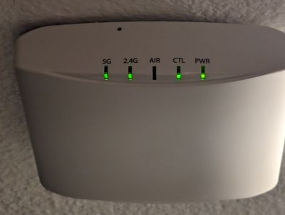

I have frontier internet in a lennar home that came with the switch. The frontier internet connects from the modem to the lennar switch. I previously did not have any issues but after having to reset the breaker, My internet from the ruckus switch keeps disconnecting after 5-10 minutes or is very slow.

Hi @mangofish
As per the case description, I understand that your RUCKUS setup is not working with the Intermittent Internet connection.
As I see from the pictures you shared, as per the Switch and Access Point light status they are in a normal state.
As you mentioned, this issue may be due to the Routing code (SPR) on the Switch and needs to bring the Switch back to the Switching (SPS) code.
Please refer to the below RUCKUS Lennar Knowledge Base self-help article which will help you get this issue fixed.
Please follow the process and let me know if you are stuck and need help at any point during the process.
