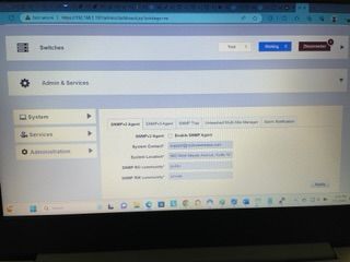

Hi @Wecovernc
As mentioned earlier, the dashboard you are seeing on the web browser is of Unleashed and not of the ICX-7150-C12P Switch.
You should see the Switch Dashboard as shown in the below screenshots to confirm it’s a Switch IP Address.
Please check the other IP Addresses from the IP scan results, by the name of Ruckus Wireless or Brocade Communications to confirm the IP address of the Switch and access the CLI.
Thank you again for your patience and understanding
I have two up addresses.
mine takes me to the GUI I sent images of.  The second ruckus ip address. Takes me to a ruckus r510 see this screen shot.
Hi @Wecovernc
Could you please share the screenshots of all the IP Scan results?
Thank you again.
 Here
