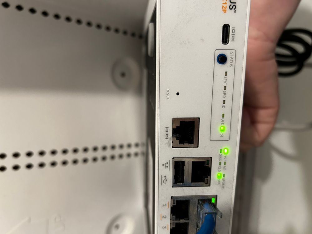

Previously, my ICX7150-C12P switch with two APs was working. I can’t figure out how to go back to broadcasting.l (now, one of them only has a solid green light at PWR and DIV and AIR, 2.5Hz and 5 Hz are not lit up, while on the other AP, the PWR light is green but the DIV light is flashing green slowly — is that just because the first is the master?) The switch is on — I think that the correct lights are on, but I can’t use the web or app way of accessing the switch and I don’t see the Config-… network (because I had set it up to be under my WiFi name).
1. Should I do a factory reset of the ICX7150-C12P switch? That didn’t work. I can’t factory reset the APs because they are on the ceiling.
2. Should “1” fix the issue (do I need to plug my laptop directly into the switch?)

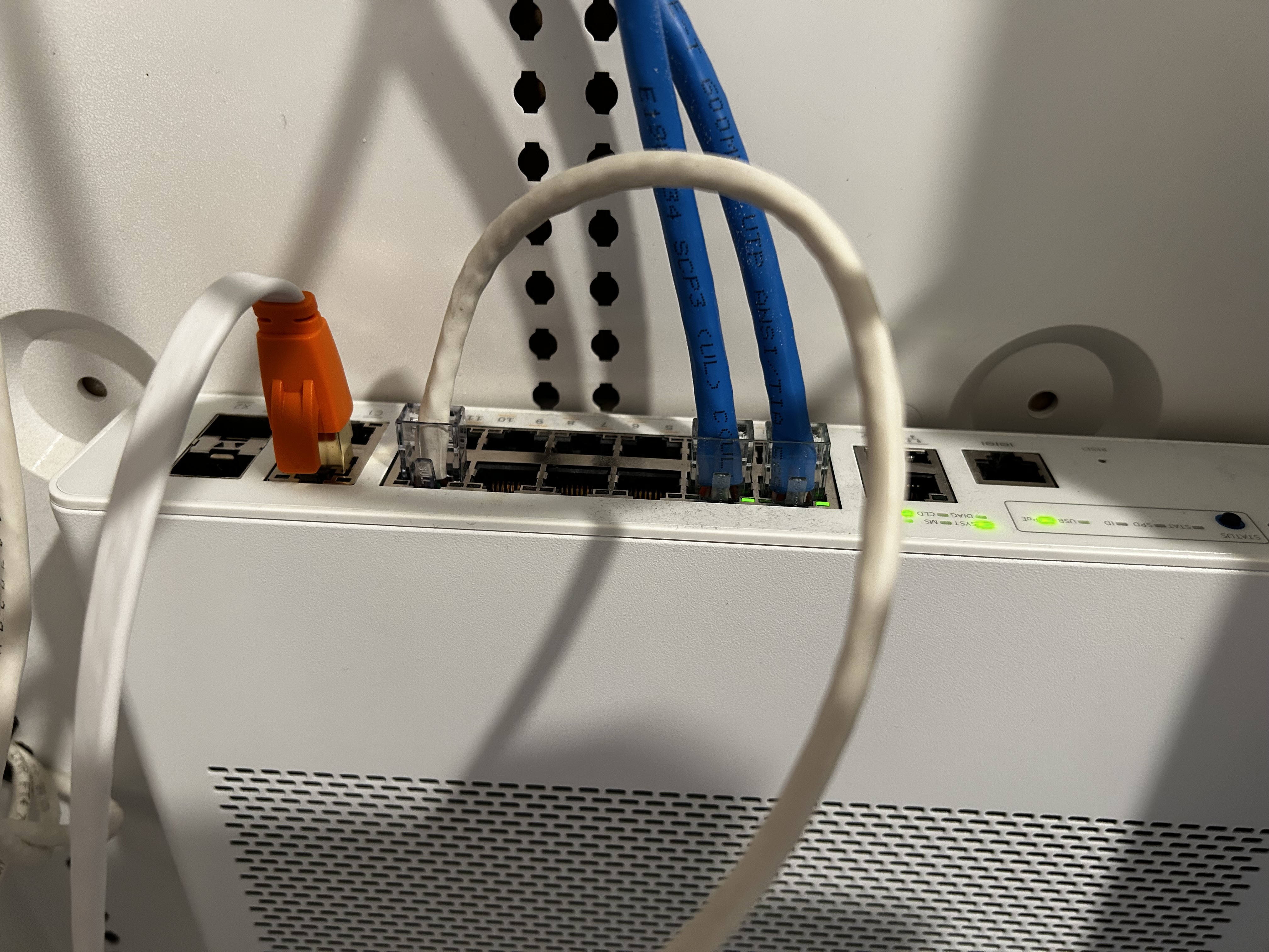

3. As an aside, when I need a very reliable connection I run an Ethernet cable from the switch to my laptop — where should I be plugging the Ethernet cable in to on the switch — it seems to work when plugged into two different places: a. One of the 12 POE ports; or b) C1/C2?.
4. What is the port right above the USB port for?
5. What is the port that is labeled “I o I o l” for?

3) Based on the images you have shared it seems like the ethernet cable coming from the router or the access points has to be connected to one of the 12 ports of the switch.
Make sure the cable is in good condition so that both ends and connectors look good.
Note : you will see a light come on when a device is connected via Ethernet on 1 of the 12 ports available.

Also to check the ports here I share the guide which gives the detailed description of the LED ports of the switch.

i plugged the Ethernet cable that runs from the Ruckus switch to the laptop into one of the 12 POE ports.
This didn’t change anything — I tried to access unleaded with it plugged in and not, and there is still no AP broadcasting.
