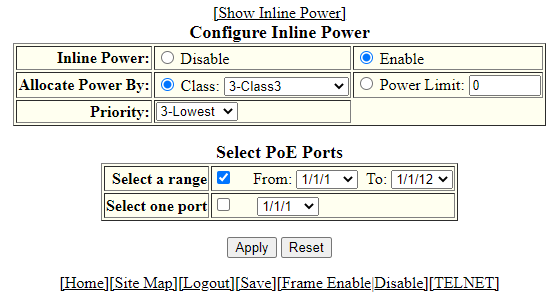

I found that the POE was not enabled by default and enabled all ports from GUI as shown below. Even after this, APs are not powered up.
Are there additional configuration required?

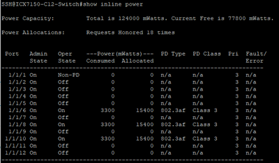

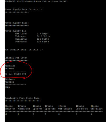

I see non-zero version numbers as shown below:
Why SPS08095gufi.bin does not configure POE?

If you do such a big step upgrading the switch it can be that it will upgrade also the POE firmware.
If I remeber right, you will see this on cli giving you the status of the POE upgrade in 10% steps. No AP will boot before that upgrade is finished and teh process starts when the switch has booted up after firmware upgrade.
It can take up to 30 minutes till it is finished.
