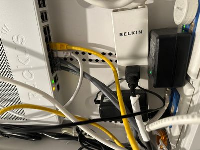

My ruckus stop working after a power outage.. what should I do… it happened before and a tech support fix it online i a minute..

Please share a Picture showing the light status of the Switch as shown in the above picture.

Hi Imran.. thank you for the quick response.. there is a green and amber light.

As you mentioned and I can see from the picture you shared, there is an amber light on the "SYST" and a green light on the "PWR" in the section above the USB/ethernet ports. Meaning the Switch is stuck in the boot mode.
Basically, due to the power outage/ power spike, the switch went to a state that we called (boot mode) that is not able to boot up properly.
Please follow to below steps in order to fix this issue:
If that does not make any difference, we need to perform a software recovery since it can be that the image flash is corrupted in basic words the unit is not able to boot up properly and need re-install the image to boot up properly.
