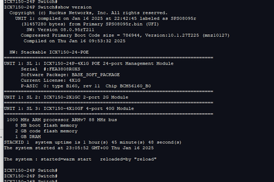

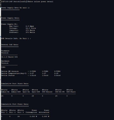

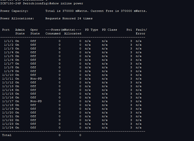

3. After successfully accessing the CLI, please execute the following commands and provide the outputs:
 show version
 show flash
 show inline power
 show inline power detail
 Please share the command outputs or screenshots if you encounter any issues or errors during these steps.
Jxck
Here is the command output as requested from the switch. Ports 9 and 10 don't work. If i switch a cable from another known good port to 9 or 10 it does not link. Thanks
