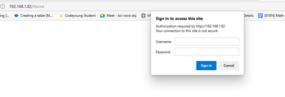

Unable to log in to ip address - I can't create Log in and Password as there is no option. I have login for Ruckus Wireless Support
But not for the ip address. Tried unleash app on iphone but that doesnt show any system attached

Hi @Satishk4
The IP address you are accessing is related to the RUCKUS ICX-7150-C12P Switch and Not RUCKUS R510 Access Points. Please check for another IP address in the IP scan list.
As described in my previous post, for the RUCKUS R510 Access Points IP address Unleashed dashboard, you should see the interface shown in the screenshot below. Please attempt to log in with the same username/password you use for Unleashed Mobile Application.

Hi, The Ruckus IP for AP is 192.168.1.81 I tried Lennar provided credentials and my UNLEASHED App crediantials but unable to log in
