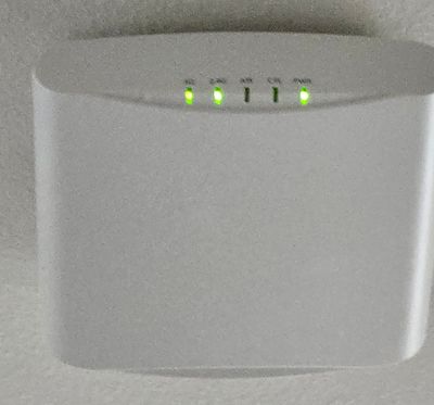

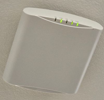

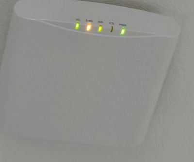

Thanks for the response. I have been getting disconnected previously so I was playing with the unleashed app and enabled Mesh and it became worse. Here are the pic you requested. I have 3 APs.
Hi @Jsphtn8
Thank you for your recent correspondence and update.
From the pictures you shared, I see that the light status of your RUCKUS ICX-7150-C12P Switch and Access Points are in normal state.
However, we may need to check some configurations of your RUCKUS ICX-7150-C12P Switch to troubleshoot this issue.
