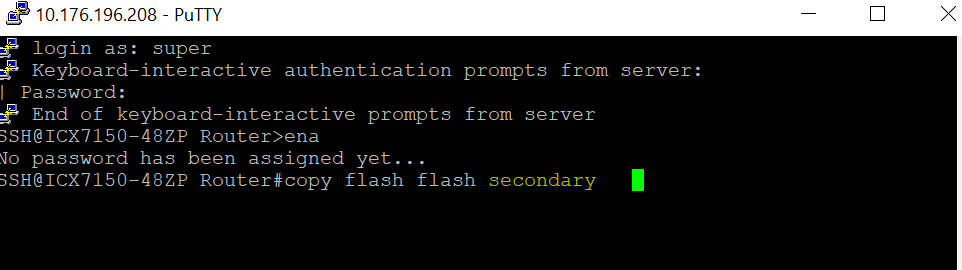

Thank you for the details provided, based on the troubleshooting you have done I wanted to confirm that your switch can boot up properly.
  1. Please follow the below commands.
    “copy flash flash secondary   will copy what is in the primary”
