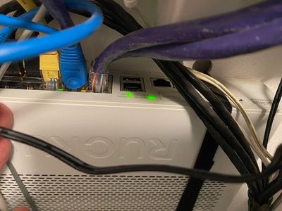

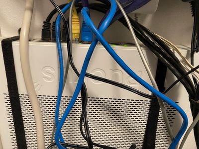

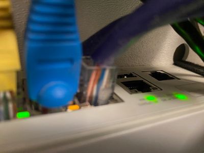

1. On your switch while it's plugged into the outlet, do you see any lights on? (Amber or green) Please let us know which lights are on. (Please refer to the below picture and share a picture of the same)
2. Also, please Make sure it is plugged into a well-known outlet/power source.
3. May I know how many Access Points are connected to the Switch?

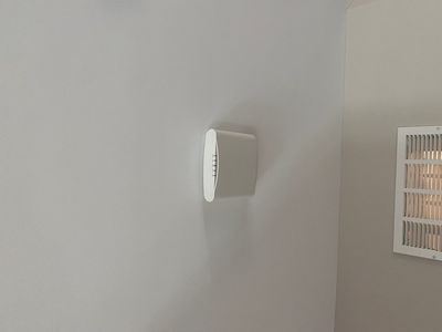

Please help us with pictures of your ICX-7150-C12P Switch showing the status of the lights. Also, light the status of Access Points.
Please let us know the answers to the above queries or if you have any queries in this regard.
Lennar Home Community.
1.  There are 3 green lights and 1 amber
2.  It is plugged in to a good source
3. There are 3 access points and no lights on any of them
The Modem/Router is 5g if that makes any difference.
Thanks for the assistance.

Hi @Zing
As per the light status of your Switch, the lights are in normal condition. And there is no issue if we use a 5G-enabled Router or Modem/Router combo.
