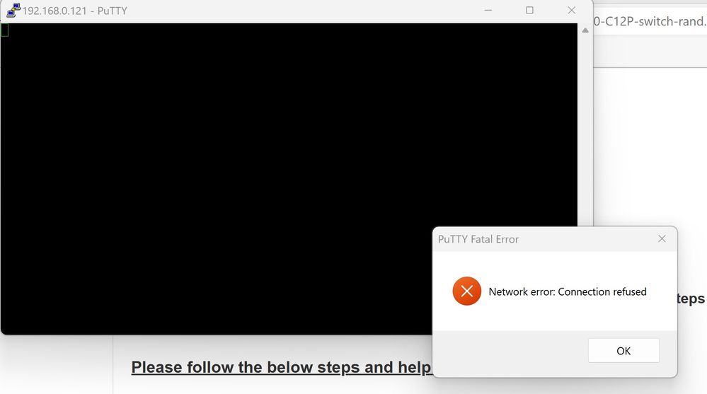

I located the IP address of my switch and downloaded the Putty application, but cannot connect. The error says network error connection refused.
07-20-2023 02:26 PM
Hi @Therealx24
If SSH isn’t working, you could try the Telnet option to log in to CLI (Putty) as described below
