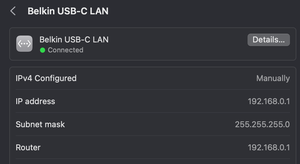

Unable to perform the software recovery. I'm using Mac and my firewall disabled. From the switch am able to ping the Mac IP, but not the Switch Ipaddr.
192.168.0.2 -> Assigned to the Switch
192.168.0.1 -> My Mac IP(Acts as gateway/tftp server).

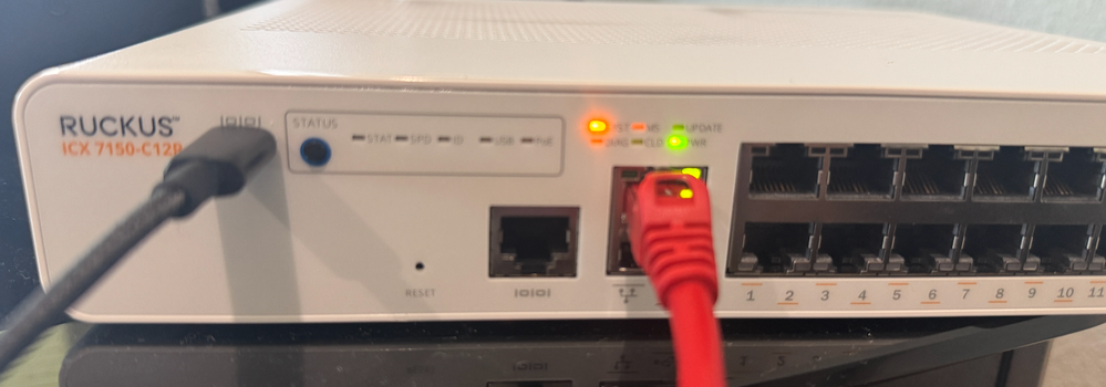

Connected the switch to mac using RJ45 cable.

Yes i was able to get to login to the switch using the suggested method.Same u can see in the messages above.
problem 1) unable to ping local ip which is 192.168.0.2 (it says not alive). Am able to ping 192.168.0.1(which is my macbook - acting as server and tftp server)
2) unable to update_primary, update_secobdary,update_uboot fails with loading *
3) when i do reset, it says cant get kernel image.
all the steps i was doing using macbook and able to get into the console.
Attached some of pics if it helps

vmk4fun
 able to fix it, issue was tftp service was not enabled on macbook.
Thank you so much for the help, the youtube video helped me
