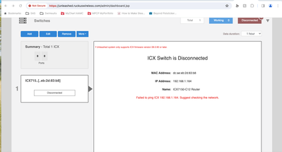

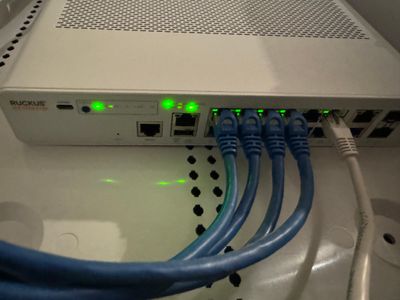

We recently had a power outage and our wifi stopped working well. In the unleashed portal i saw our switch was noted as disconnected. On the physical switch the SYST and PWR Lights are green and everything appears to be fine same with all of our APs. Research in this portal led me to this post https://community.ruckuswireless.com/t5/RUCKUS-Support-for-Lennar-Homes/Unstable-Lennar-Ruckus-Servi... and I also tried to access via inputing the IP address of switch in browser and login, but non of the various combinations of passwords from the forum worked. When going through the steps in the linked post this was the command line issues i received.

For detailed understanding of the issue please share the image of the switch and the access points showing the LED status and the cable connections.
Also please login to the switch using the IP address and share the screenshot of the status of the switch.

As already mentioned in the previous posts, please share the image of the access points showing the LED status.
