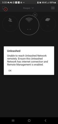

Lennar owner. We had a power outage and the AP's are broadcasting "Recover.Me". Well the instructions I found on the forum say to log in with the serial number as the password. Problem is, I cannot get the access point off the ceiling to see the serial number on the back of it. The forum instructions say "in that event, log into the Unleashed app and pull it from there". Well, obviously someone didn't tell the support technician that when your network is offline, nothing shows up in the Unleashed app, but a message saying your network is offline. I can't see my ICX switch or my AP's in the App right now and I won't be able to until I recover my access points. But I can't do that without the serial number. Is there a way to get this number that DOESN'T involve factory resetting my AP's, burning my Unleashed network to the ground and starting all over from scratch?

05-03-2024 10:19 AM
I was afraid of that. Wanted to avoid rebuilding the net in Unleashed due to a simple 3 hour power outage...but I guess it can't be helped. Thanks.
