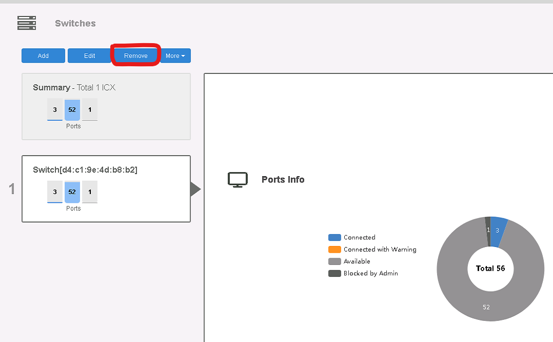

1.  Remove the existing Switch from the Unleashed (Please refer to the picture below):

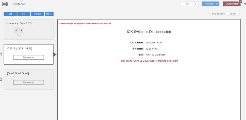

I have tried all these steps and still no luck, the switch was already added to the system it’s just showing disconnected.
Failed to ping
And it has a weird ip address starting 10.22 and I can’t log into the switch itself through that ip address.

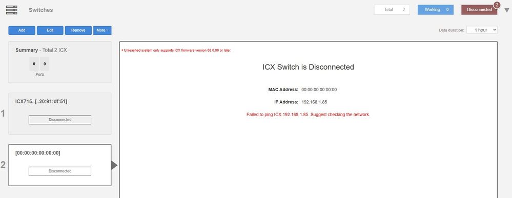

sc2.jpgsc1.jpgwhen I type in the ip for the switch which (pictured as number 2 in the screenshot) I obtained with advance ip scanner, it pulls a different ip and mac address and adds the info you see showing ICX7150 with a different ip.
