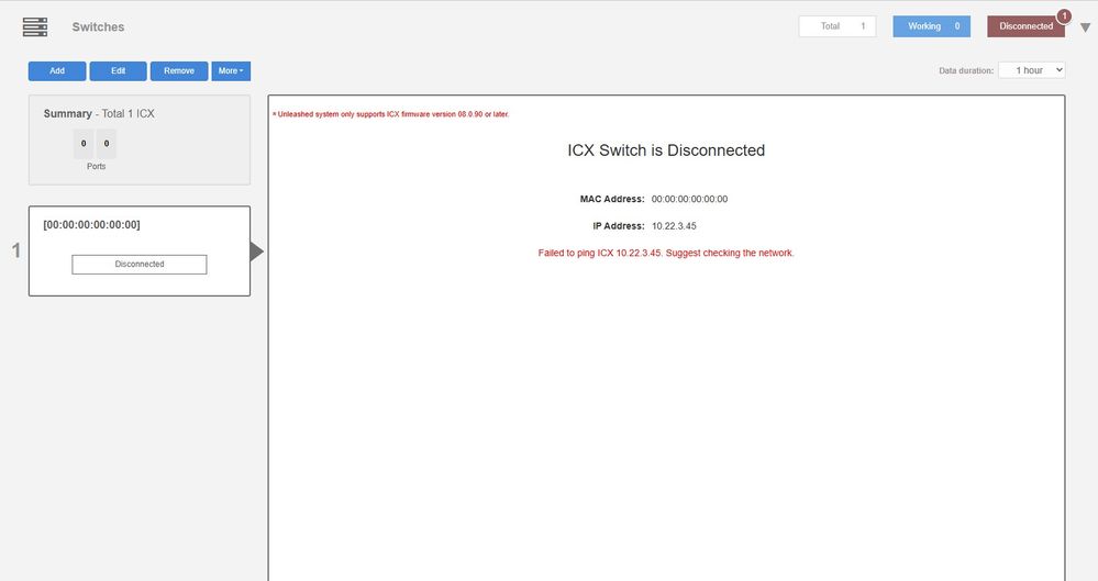

I upgraded my switch to the recommended firmware and it’s still showing disconnected
Kld88
I just need help at this point, I’ve followed all the solutions but don’t see any that have my specific issue.
My switch shows sps but I cannot type the up address in to access it considering it’s showing two switches and two different ip’s

ICX7150-C12 Switch#show ip
Switch IP address: 10.22.3.45
Subnet mask: 255.255.255.0
Hi @Kld88
Thank you for your response and for sharing the information.
Please use the Switch IP Address 10.22.3.45 in Unleashed and try adding it to the system. Refer to the Article shared in one of my previous posts on adding the Switch to the Unleashed.
Kindly let me know the outcome once you have tried this.
