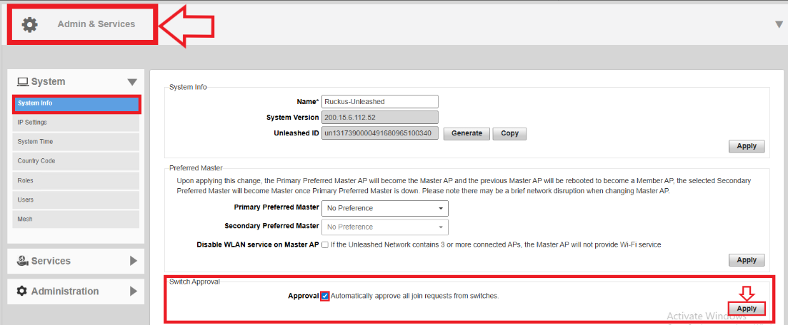

Additionally, kindly check if Switch Approval is enabled in Unleashed (refer to the screenshot below).
Please provide me with the requested information once completed.

Approval is enabled
