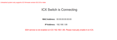

I am getting below error while adding the switch in unleashed portal
SSH service is not enabled on ICX 192.168.1.88. Please manually enable it on ICX.

04-17-2023 12:43 PM
Hi @MohitJain
Thank you for the information and update.
Actually, you need Not to add the Switch to the Unleashed, it will get added on its own after sometime.
Could you please share the screenshot of the error that you are getting on the Unleashed.
Thank you again.
Lennar Home Community.
04-17-2023 12:45 PM
Error screen shot.
