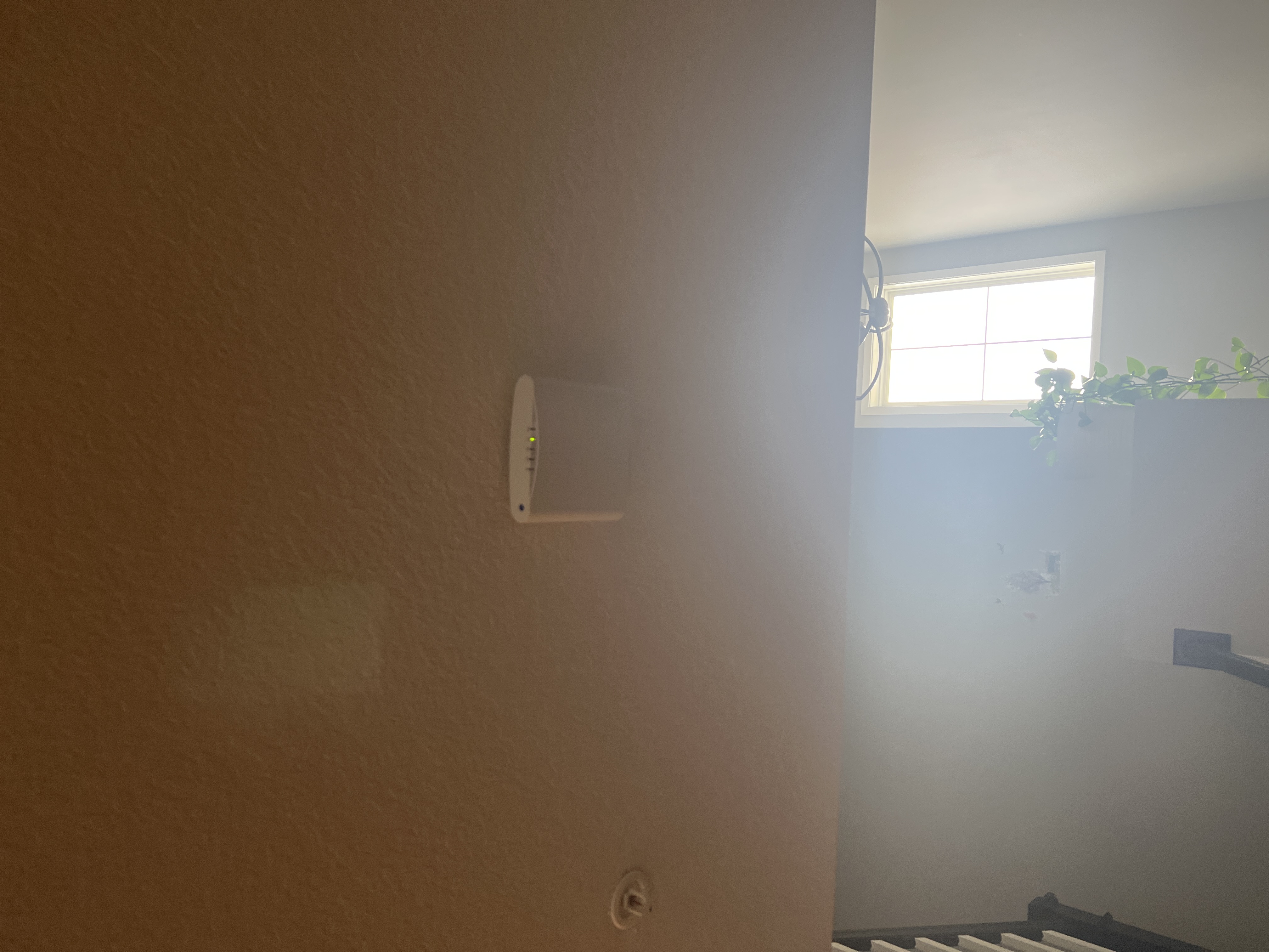

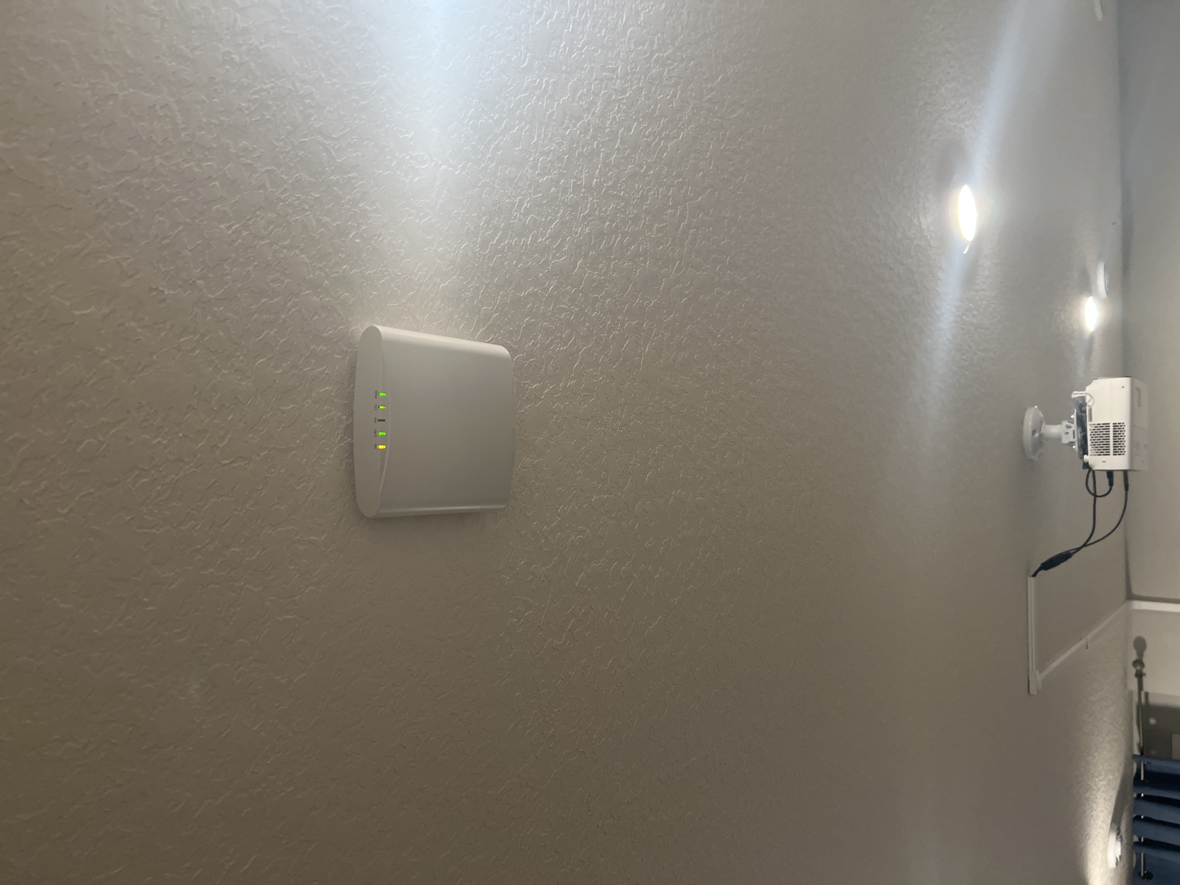

Hi Team,
After new modem and router AP’s are not connecting. I have 3 AP’s. 1 AP which is in my basement has power light blinking ctl light stable 2.4 is green stable and 5 is amber and other two AP’s power and ctl both are blinking and I see 2 configure.me SSid and one of them is primary wap. I tried to connect the configure.me after factory reset and it says building unleashed network but not moving after and it stuck there for an hour. What to do next

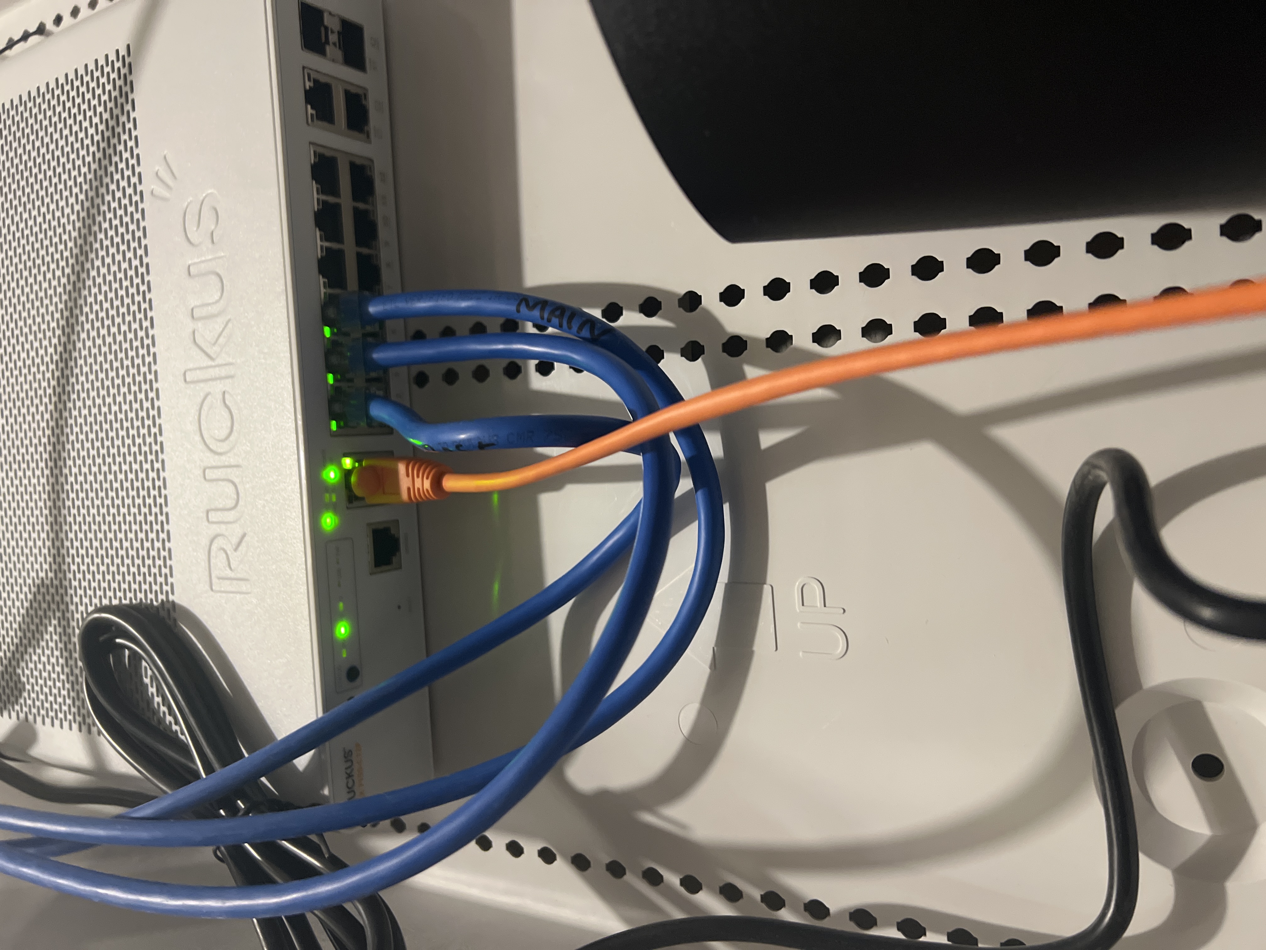

Hi @Sivaveeraraj
Hope you are doing well!!!
As per the case description, I could understand that you are unable to connect to your RUCKUS Access Points after connecting a new Router or Modem/Router combo device to the ICX-7150-C12P Switch.
As I see from the picture you shared, seems like the ethernet cable which is coming from the Router or Modem/Router combo is plugged into the wrong port on the Switch panel. It must be plugged into any 1 in-12 ports as shown in the below screenshot. Please unplug the ethernet cable and plug it into the correct port and try again.
Please refer to the short guide link below about how to connect the devices as reference:
Lennar Home Community.

04-17-2023 05:31 PM
thank you imran. i factory reset one of the AP and its connected now and i can able to connect to unleashed network after that i connected back other 2 AP's but that AP's are still showing amber light in 2.5 and 5 light. but in unleashed network admin page shows all 3 AP's are working status.
