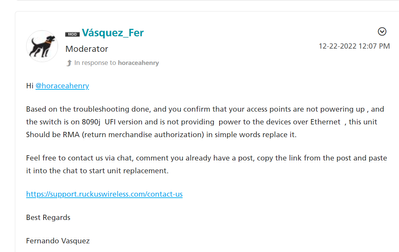

My ICX 7150-C12P unit has to replaced again due to power loss in the home. My R150 units are not receiving power "PoE" from the main switch. This has happened to me once already and is very frustrating. I have power cycled both the routers and the ICX, as well as reset (little reset button, hold 10 seconds while powering on) the ICX multiple times. What are the new steps to getting the unit switched out? Thank in advance? Also what are recommendations to prevent this in the future

My coworker have approved you the RMA for the unit, no sure why you're still trying to troubleshoot the unit, important as soon you receive the RMA unit, please upgrade to the code 08095g UFI, the file you need to use will be SPS08095gufi.bin, and upgrade both partitions primary and secondary.

We cannot approve an RMA without troubleshooting, that is the purpose of the forum, my coworker guide to isolate the root cause of the issue, remember to copy and paste the RMA approval post in the chat with the RMA team, so they can proceed with the RMA.
