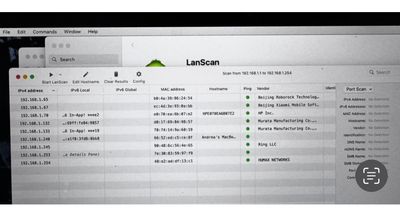

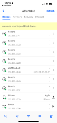

I ran Fing on my iphone and LanScan on my mac. Results are below and I don’t see anything that could be the Ruckus Switch?
Hello @Andrea ,
From the response you shared, I understand that the  Switch IP address details are not available or the Switch with Brocade Communications or Ruckus Wireless is not visible under the LanScan results.
