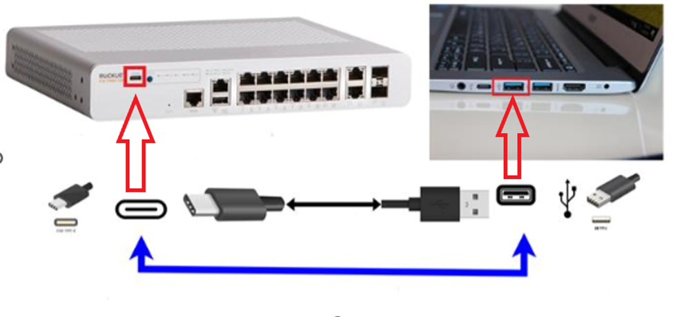

Hello @Andrea ,
The cable should be a type C to USB connector as shown in the below figure
Could you please share a picture of the cable connections between Switch and laptop?

The MAC computer requires a type “C” connection. It does not have a USB. According to your diagram there are two console ports # 1. Type C and # 15. The RJ-45. The console cable I purchased is a Type C and RJ-45. Can I use this cable with my Mac? Will the Putty/MobaXterm work if I’m not using a USB?

Hello @Andrea ,
Thank you for your response.
I understand that you are using a cable with a Type-C to RJ-45 connector.
You may utilize an external adapter to connect the cable from the Switch to your Mac laptop.
To assist with obtaining console access on a Mac, please refer to the following video:
Video on Console Access for Mac
