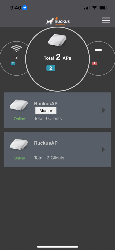

Hi, I did a factory reset and everything seems to be working fine so far. However, I’m noticing 2 issues. 1. I’m not getting alerts though my iPhone unleashed app logging on with the new IP address anymore. The alerts tab used to be in the upper left corner of the app. 2. My switch is showing disconnected.

I’ve seen other posts where you cut and paste a bunch of these due the system not working after a power outage. This is NOT my issue. I did not have a power outage and my network is working fine.
2. My switch is showing disconnected in the unleashed app but is obviously working.
Are your instructions necessary to get the above working? I’ve spend weeks going back and forth with you on my issues and feel like I’d be starting over. Please advise.
Valued Contributor III
Hi @Rolo106
As you are having " Switch Disconnected" issue in the unleashed app this is the solution to solve the issue.
Please try to get access to switch via Switch CLI (command line interface) via SSH, Telnet or console using the below link.
1:Find the IP address of the Switch:
2:Once you know the IP address, gain access to the Switch via Telnet, SSH, or console.
How to Access an ICX Switch remotely via SSH or Telnet, using a Windows computer
https://community.ruckuswireless.com/t5/RUCKUS-Support-for-Lennar-Homes/How-to-Access-an-ICX-Switch-...
How to console in the ICX-7150-12CP 'Ruckus Switch'
RUCKUS ICX 7150 USB TYPE C CONSOLE (tutorial video for ICX)
https://www.youtube.com/watch?v=YXR4xhkw3q8
(Tutorial for MAC)
https://www.youtube.com/watch?v=1AcJokMm78U
3:Now you have accessed to perform an upgrade, which can be done via TFTP or using a USB
