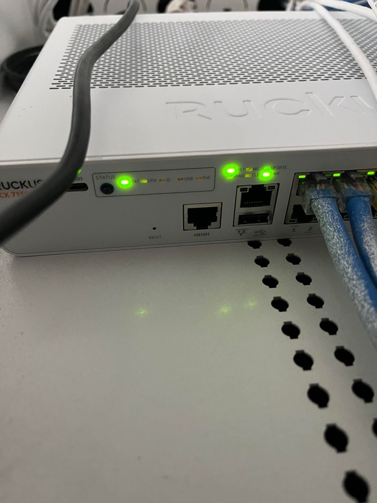

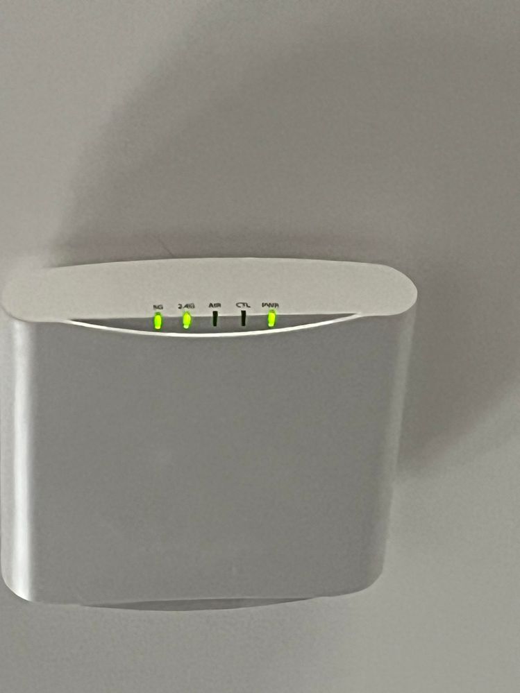

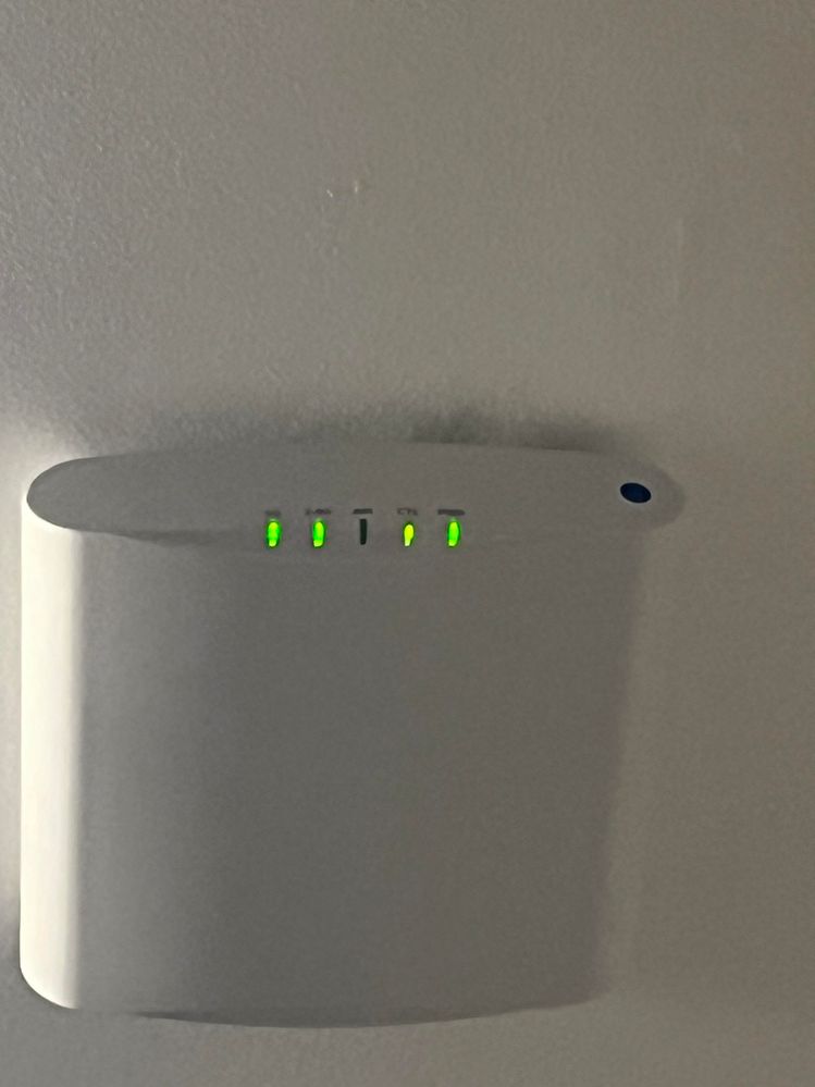

Hello!
I am experiencing heartbeat loss on both APs at the exact same time about 12 hours apart but sometimes sooner, then they come back online a minute or two later at the same time.
This setup was working just fine for about three years before experiencing these issues. There may have been a power outage around the time it started happening but not sure. It does seem to have started happening after I updated the firmware from 200.12 to 200.14
Images below - I also have logs if that is helpful.
