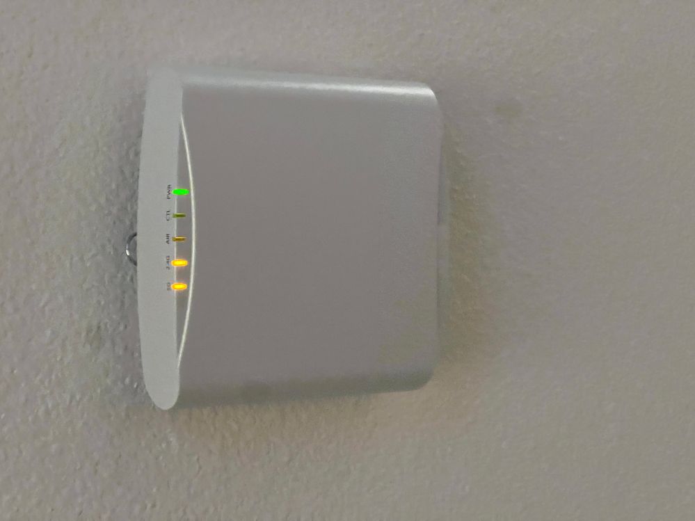

During update of unleashed firmware my internet connection disappeared, the extender router started showing amber light on 5G and 2.4

I received the AP R510 replacement, which I connected, but the same problem persist. The configmeXXX (SSID) disappears every time right before completing the full AP reset.

I reset it about 7 times, following the steps provided above, without success. Same lights on AP, and not able to connect to configmeXXX, it disappears before the AP reset is completed.
