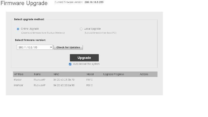

Here is what I have discovered at this point:
Prior to performing an online or local upgrade I start with the following:
Image_ images_messages_61e32a0df693d71b8f6f5e78_50fd462de11b8c462705657df1a1a963_1-6c15ebaa-3126-4636-9782-40395b7c35db-46728356.jpg
After having performed the online or local upgrade I receive the following and I downgrade as instructed:
Image_ images_messages_61e32a0df693d71b8f6f5e78_dddd21e287e8b6d34af1c7aebda8be05_2-1d96ee51-d237-4c94-a8b9-ccc8236c1fde-47651877.jpg
At this point I remain with 200.10.10.5.253 on my R510s.

BrianE
Vijay,
Thank you for replying.  I've been looking forward to your answer.
In the past when I have upgraded the firmware there was no indication for a downgrade to the previous version which is why I was concerned when I saw this, especially given that it's in red!
I have to admit, it does appear to be working fine though!
It would be helpful if something like the following was inserted into the release notes:  "The message 'The system will be downgraded to the specified version of 200.10.10.5.253, and restored configuration to 200.10.10.5.253' can safely be ignored as it's only for informational purposes and the firmware upgrade was successful."
