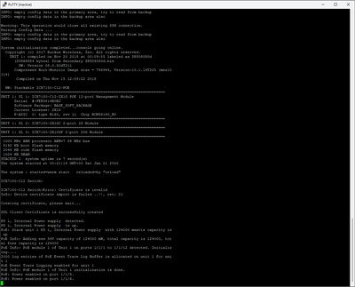

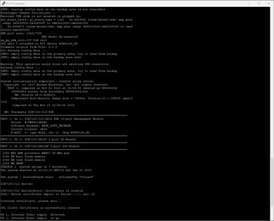

03-01-2024 12:38 PM
I did all that and it led to nothing.
03-01-2024 12:44 PM
Hi @BillRamos
You are getting the correct Console CLI window.
This issue is because your switch is running on the Routing code (SPR). The Switch should run on the Switching code (SPS) to avoid these issues for Lennar home users. Due to a power outage/power spike, the Switch boots up on the other partition which may be running on a ‘Routing Code’ results in causing this issue.
As I can see from the output you shared, your Switch is booted up on the secondary partition which is running on Routing code (SPR) as highlighted in the screenshot below.

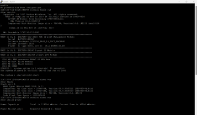

03-01-2024 03:07 PM
I entered the following as instructed:
copy flash flash secondary
But I do not get ICX7150-24P Router>enable but rather the screen is blank, I type "enable" and as yo can see it says No password has been assigned yet...
ICX7150-C12-Router#TFTP session timed out then I enter "show version" and you can see the rest yourself.
As a side questions, what am I trying to accomplish, turning it back into a router or a switch?

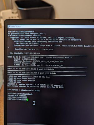

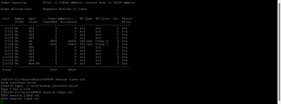

03-03-2024 05:47 AM
I followed all the steps provided, please see below. The wifi worked for a few seconds then went out again. I am exactly where I was when I first reached out.
If I disconnect the Ruckus from the router I have hard wired internet and no wifi.
If I connect the Ruckus to the router I lose the hard wired connectivity and still have no wifi.
WHen I try to connect to my home wifi network my phone shows my network as "Saved/No internet access".
