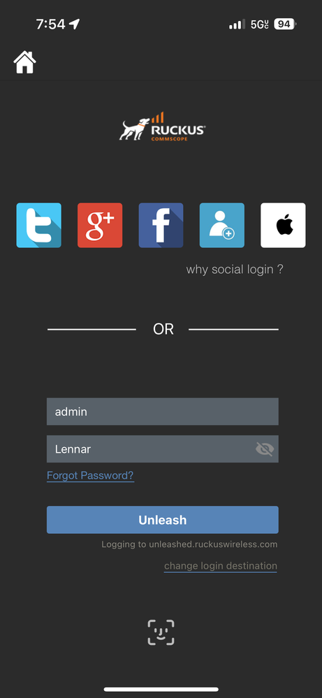

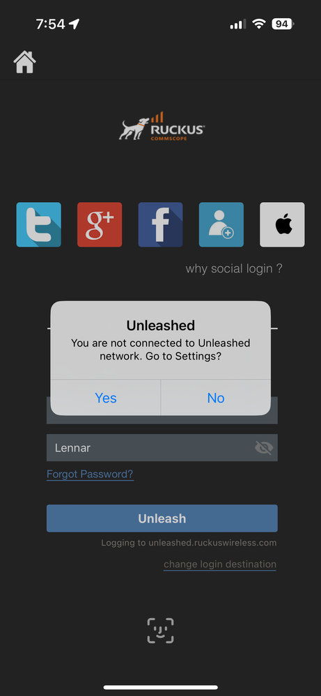

Hey,
I have Lennar home and ruckus R510. Before system was set up for login admin and password Lennar, but when I'm trying login in to "my account" I can't. My xfinity network shows me high speed, but when I try use my home network pages freeze. SN# 372072005569

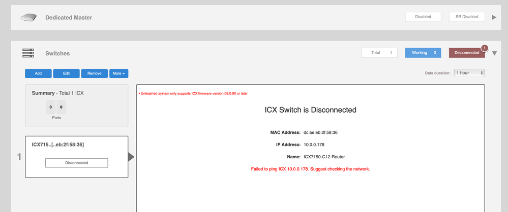

Hi @Barb
Do you have access to your Xfinity router through either an application or a web interface? If you do, could you please verify whether you can find the IP address assigned to the ICX7150? I noticed that you attempted to use an IP scanner, but the two entries labeled "Ruckus" are likely your access points, as their MAC addresses don't match with the ICX7150.
If you can find it then you can follow the steps below:
2-This guide show you how to access remotely to your switch
3-Here are the steps how to fix the ‘routing code’ step by step (2 guides)
In simple words write the following commands and hit enter to accept each command:
ICX7150-C12 Router#enable
ICX7150-C12 Router#copy flash flash secondary
ICX7150-C12 Router#boot system secondary yes

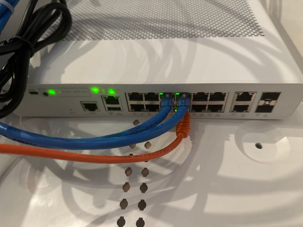

If you don't have access, please provide a photo of your ICX7150 switch with cable connections. I need to confirm that the Xfinity router is properly connected to our ICX7150 switch.
(Refer to the image below and share a corresponding photo, displaying the complete switch panel with cable connections to the switch ports.)
Note: Ensure that ALL cables are connected to the 12 ports on the front panel, organized in 2 rows of 6 ports each.

Could you please pay attention- I have Mac, not windows. I'm so tired go back and forth. Please check my conversation from the beginning. I'm sending now picture of my router. Please try do your best to help me.

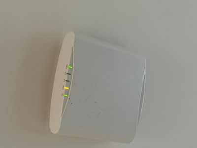

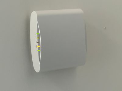

What specific symptoms or issues are you encountering when connecting to the Ruckus-Wifi network (distinct from your xfinity router)? For instance, are you experiencing problems such as websites not loading, devices disconnecting or facing functionality issues, network dropouts at random intervals, smart devices unable to connect to the internet, or the Unleashed dashboard occasionally displaying "Disconnected" in the Internet tab, among others?
May I know how many Access Points are connected to the Switch? Could you please let me know the light status on the Access Points? Any of these lights are on (Please refer to the below picture and share a picture of the same)

11-05-2023 06:08 AM
2nd floor
first floor.

I'm on my admin profile but my switch doesn't work. Please let me know how can I fix it! there wasn't ip address, I added
my admin pageI installed LanScan to check switch ip address but still doesn't work.
