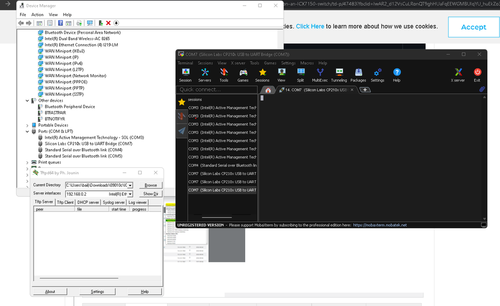

Thank you for the suggestions. I have done as you have suggested--rebooted the Switch and tried to access CLI. I tried it will all the other ports. I got the same result and downloaded the MobaXterm app and tried the operation again with the same results as you can see from the attached screenshot. I am open to any to any other suggestions you might have, but so far I am still without a working Ruckus Switch.COM 1.png

Hi @Wxdude
Greetings of the day!!!
Please help us with the PICTURES and VIDEO consisting of the following process mentioned below:
Single Video should consist of –
1. Showing Physical cables setup between Switch and the Laptop.
2. Showing IP configurations.
3. Showing Device Manager COM port information.
4. And accessing CLI/Console using Putty by the Switch COM port.
Thank you, Imran. A video showing the elements you asked for has been uploaded to the link you specified. Please advise me on how to proceed.
