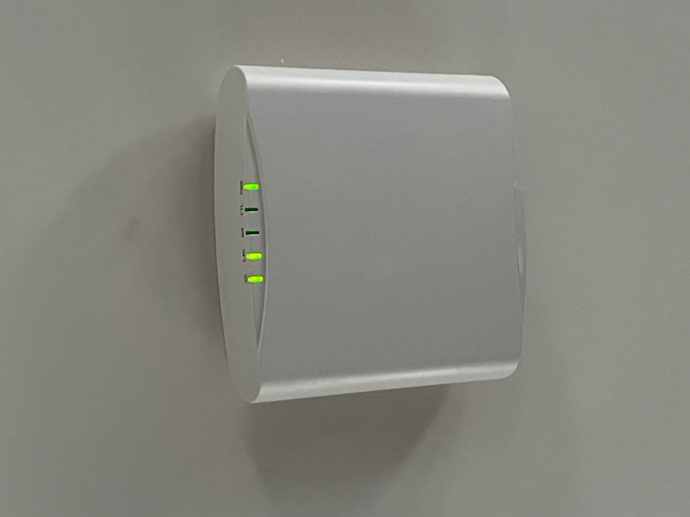

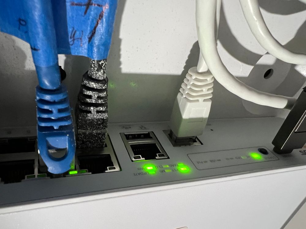

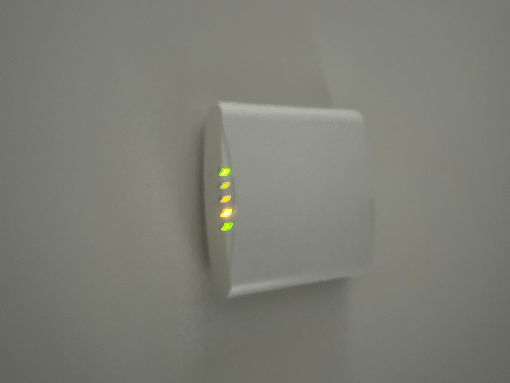

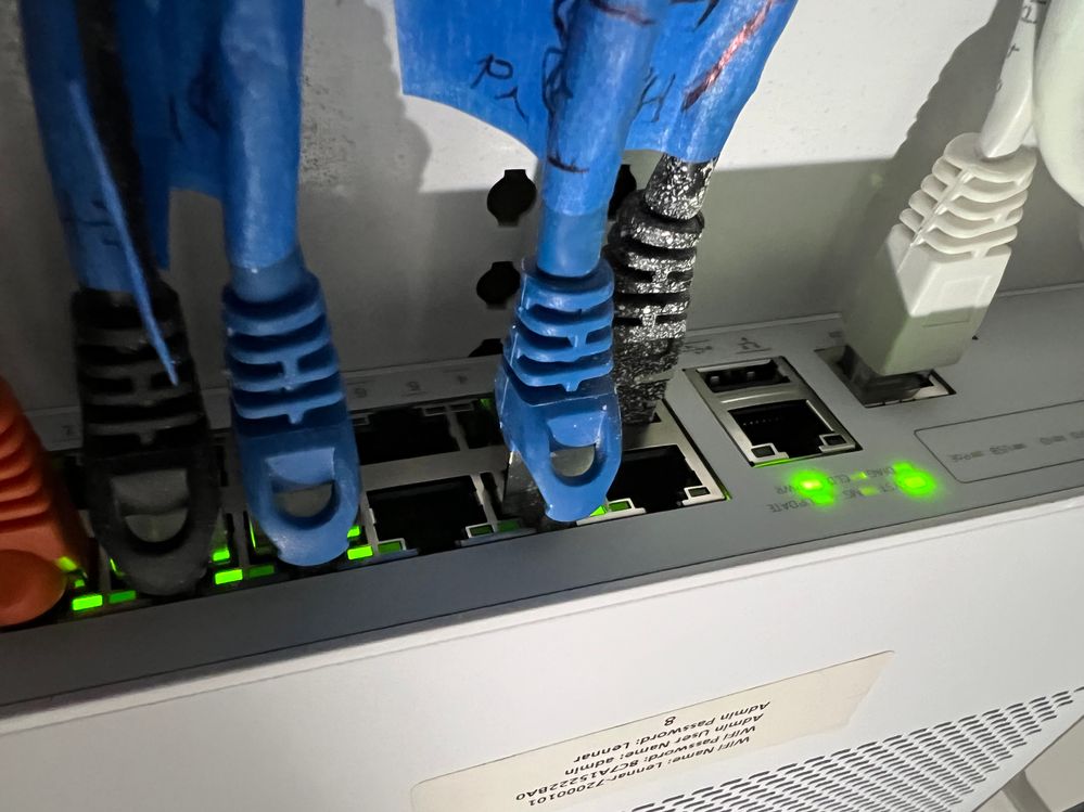

Based on the description you have shared it seems like your switch is running on routing code. For further troubleshooting steps please share the image of the switch and the access points showing the LED status.
Hi JayaVidhya,
Thanks for the quick response, see the screens attached.
Hi @VM_sky99
Thanks for your response.
Based on the images and the information you have shared it seems like your switch is running the routing code. To avoid these issues the switch should run on the switching code.
