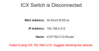

My whole Ruckus system has not been working for the past few months. I finally got around to trying to fix it and did a reset of the system, but I'm not getting any better results. According to the online Unleashed system, the switch is disconnected. I have the switch's IP address after following one of the forum posts. When I try to remove and add the switch back, it says that it fails, "Failed to ping ICX (IP Address). Suggest checking the network."

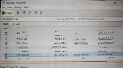

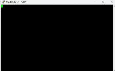

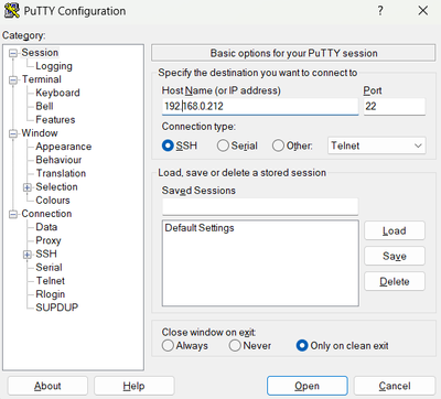

07-29-2025 10:40 PM
Thank you for the instructions. I've tried to access the CLI with both the SSH and Telnet options, but I do not get the "ICX7150-C12 ___" command line (see images below). I cannot type anything in that blank putty screen either, and it just times out. Part of the issue with my inputs is that I do not see a location to put my login credentials.
I followed the instructions of the first link to get the correct IP address for the switch (see screenshot below)

07-29-2025 10:43 PM
FYI, this is the error message I get for my switch:

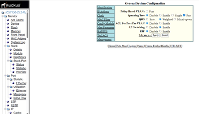

07-30-2025 08:48 PM
Hi Pinky,
I was able to log in with your instructions and got to the screen shown below.
