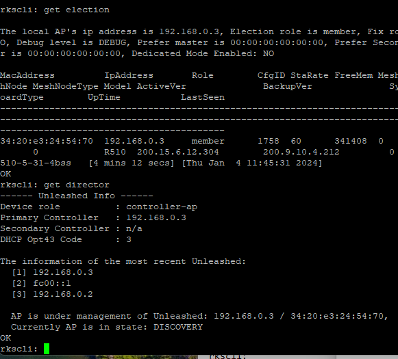

I have performed factory resets, upgraded firmware via tftp, and I can access CLI.  What I can't do is get one of them to become Master nor can I get them out of discovery mode.
Both APs are running version 200.15.6.12.304

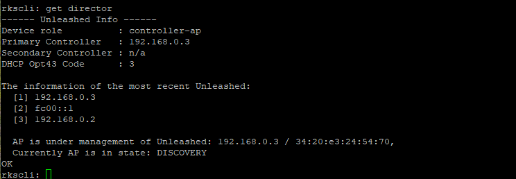

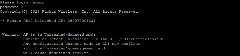

I have performed every step in the guide to reset Unleashed (except could get neither AP to Ruckus#, both were rksci which is extremely limited coding).  This is the guide I followed: https://community.ruckuswireless.com/t5/RUCKUS-Self-Help/How-to-reset-entire-Unleashed-network-for-r...

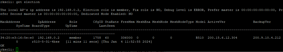

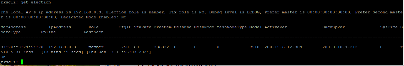

One AP has IP address of 192.168.0.2.  The other, 192.168.0.3.  Here are pertinent screenshots:

HOW can I get one of these APs to assume master and get out of "Discovery" state so I can use Unleashed app to reconfigure my network?

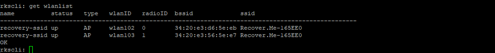

I have tried web interface and indefinite response is: "Building the Unleashed Network" It may take FOREVER.
I have tried the app using direct ip address and it will not connect.  I even attempted to change "Recover.Me" said to Configure.ME and log in.  This was the closest I came to getting access.  The app attempted to connect several times, it even said "Great! You are connected to a Ruckus..." however, after a few minutes it resolved to say "although you are on a Ruckus device, please wait until the Wifi signal shows on your phone".  It never did.

Is there anyway to configure the AP through CLI when it is in rkcli ?  Ruckus documentation says you can program as master by executing set election role 2 however, the AP will not accept that command and the only allowed options are "0=Clear" and "1=member".  It also states that when in rkcli:(config ap-mode): you have full rights.  I attempted to enter "ap-mode" numerous times without success.  How can you enter ap-mode when in rkcli:?
