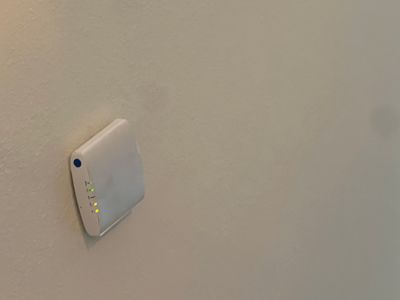

Green lights

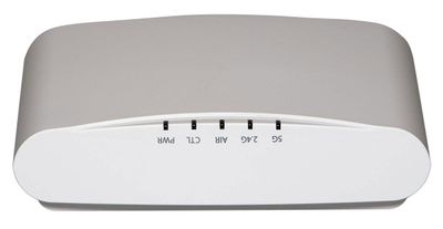

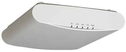

Which lights are on on the Wireless Access Points ( boxes on the ceiling ) ?

1st 2 are still yellow, 3rd is off and the last 2 are green.
01-05-2023 08:21 AM - edited 01-05-2023 08:22 AM
Hi @Gabrielle88
Hope you are doing well!
The yellow light means that there are not clients connected on that specific Radio (5G or 2.4G) that depends where is the yellow light on.
This does not mean that the Access Point is broken or damaged.
Here is the meaning of each light on the Wireless Access Point
Yellows light 2.4G: Radio is up, no clients are connected to the 2.4 GHz radio.
Yellows light 5G: Radio is up, no clients are connected to the 5 GHz radio.
So, if there is a device (iPhone) that is using the 5G radio, the light on the Access Point will be turning green on the 5G radio indicating that there is a client/device using that radio (5G)
