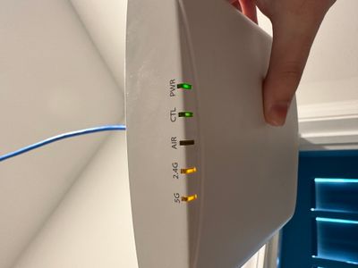

below is what the colors I get after each time I try and factory reset. (Hold reset button til turns red and then 20 secs)

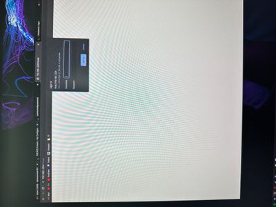

The screenshot for logging into AP is too large but just says login information is incorrect. Please try again.
