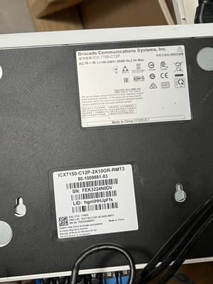

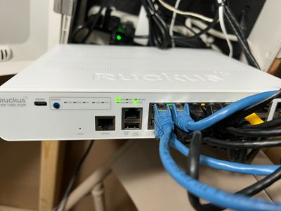

2. On your switch while it's plugged into the outlet, do you see any lights on? (Amber or green) Please let us know which lights are on. (Please refer to the below picture and share a picture of the same)
Please help us with pictures of your ICX-7150-C12P Switch showing the status of the lights.

1. There was no power outage, all of sudden it stopped and AP stopped working.
2. Attached the pics as requested.

Hi @vchekkilla
Sometimes the Switch may require a hard reboot (disconnect and connect the switch from the power outlet). Also, Unplug and plug the ethernet cables from the Switch ports panel and plug them back again.
Please let me know if that works or doesn’t to assist further.
