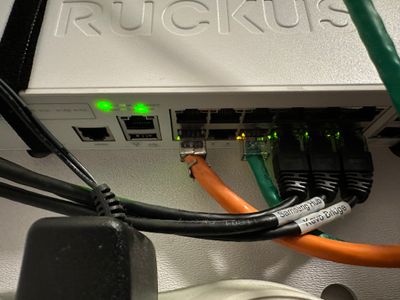

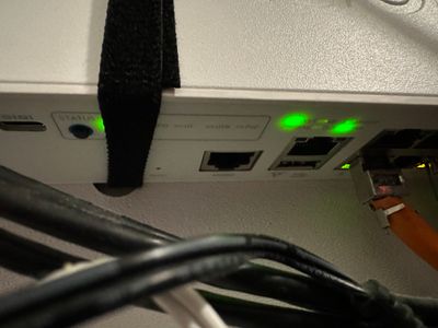

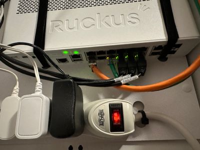

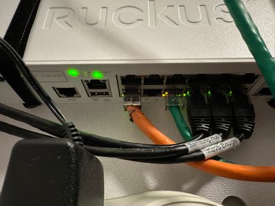

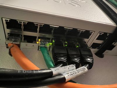

2. On your switch while it's plugged into the outlet, do you see any lights on? (Amber or green) Please let us know which lights are on. (Please refer to the below picture and share a picture of the same, showing the light status and the FULL Switch panel cable connections to the Switch ports)

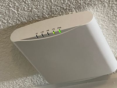

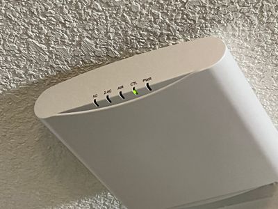

4. May I know how many Access Points are connected to the Switch? Could you please let me know the light status on the Access Points? Any of these lights are on (Please refer to the below picture and share a picture of the same)

2. There are lights on the switch. There are 3 status lights that are green. There are 5 Ethernet cables plugged into the switch, 4 are green and 1 is Amber. The SYST light is green. The power light is green.

4. There is one access point connected to the switch. Power button is flashing green and the ctl is solid green.

Getting you images.

10-18-2023 01:09 PM
10-18-2023 02:02 PM
Hi @Melguzman
Could you please identify the cable that belongs to the Access point and unplug it and plug it back?
