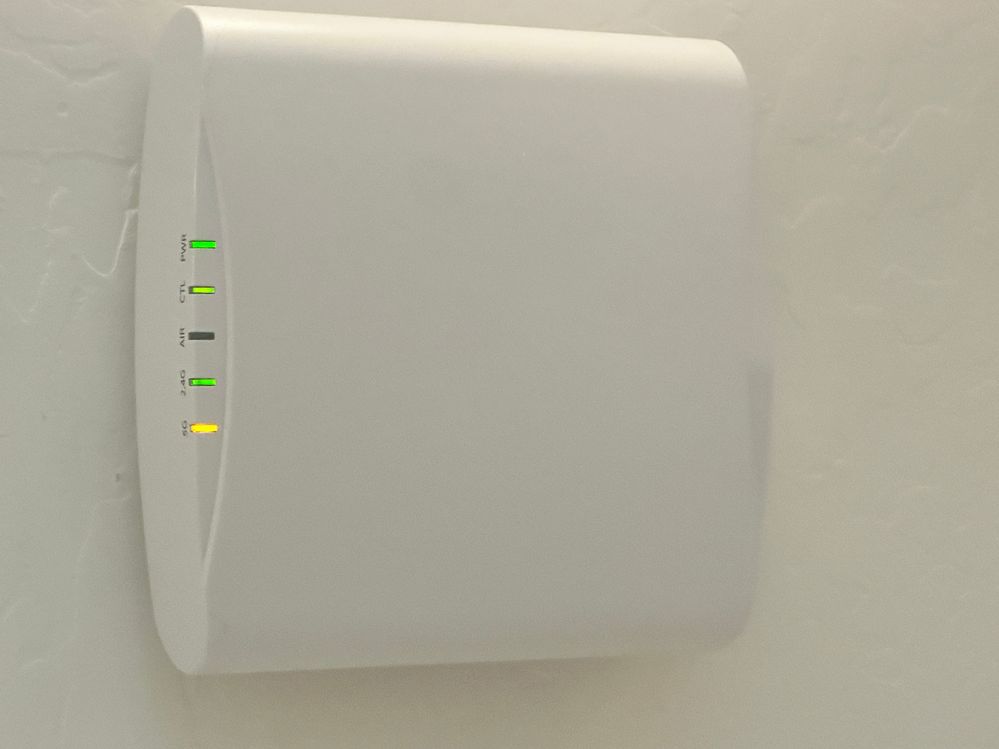

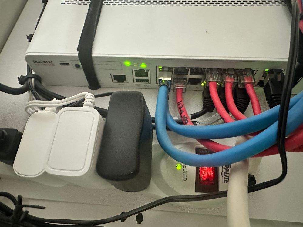

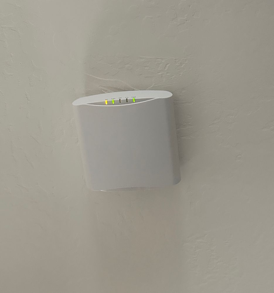

4. How many access points are currently connected to the switch? Please describe the status of the lights on the access points. Similarly, include a photo showing the access points' light status.
12-26-2024 08:47 AM
1. yes it was operational, and there may have been a power outage.
2. Photos attached.
3. Yes ISB works great 1000mb speed.
4. 2 access points. photos attacehd.
thank you!ap 1
ap 2
switch

Hi @tommybandit
As per the light status of the RUCKUS ICX-7150-C12P Switch and the R510 Access Points, they seem to be in a normal status.
As I see from the picture you shared, it seems like the ethernet cable which is coming from the ISP’s (Internet Service Provider’s) Router or Modem/Router combo is plugged into the wrong port on the Switch panel. It must be plugged into any 1 in-12 ports as shown in the below screenshot. Please unplug the ethernet cable and plug it into the correct port. Once connected please reboot (unplug and plug from the power outlet) your ISP router once and try to connect to the Internet via Access Points.
Please let me know if that works and let me know if you have any queries in this regard.
12-26-2024 10:07 AM
Ok that worked. The network now has internet. But I cannot connect to my settings on the app or the website.
