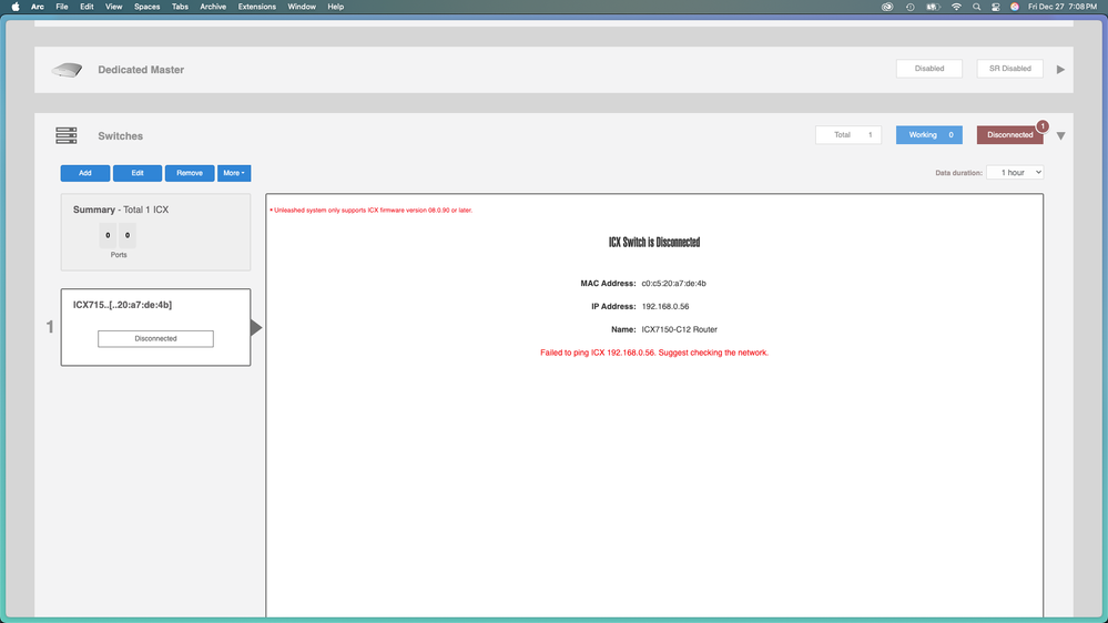

My Ruckus ICX 7150-c12 isnt working correctly.  My internet on both of my ap is super spotty now. It also shows this now when I'm logged in to my ruckus.

I see from the screenshot you shared, that your RUCKUS ICX-7150-C12P Switch is stuck on the Routing code (SPR) causing the issue. (Refer to the below screenshot)
To troubleshoot and fix this issue, please refer and follow to the below RUCKUS Lennar Knowledge Base self-help article.
https://community.ruckuswireless.com/t5/RUCKUS-Lennar-Support-Knowledge/Fixing-RUCKUS-ICX-7150-C12P-...
Please follow the steps to fix it and let me know if you are stuck at any point during the process.

Which firmware version are you running on your ICX 7150-c12? The latest 10.0.10F seems to have issues with unleashed. The latest 9.0 worked fine for me. Does this switch also power your AP's? That would explain the problems since the switch doesn't communicate correctly with unleashed

I did this the other day. It's all fixed now. thank you
