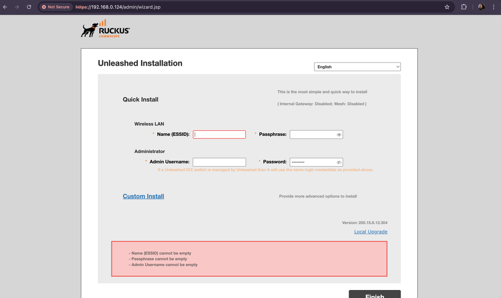

I was able to find an IP of one of the AP via the admin dashboard of my TP Link router and was able to get to this screen but I am afraid of doing anything more - should I fill this out with the same network details I've been using and click OK?
