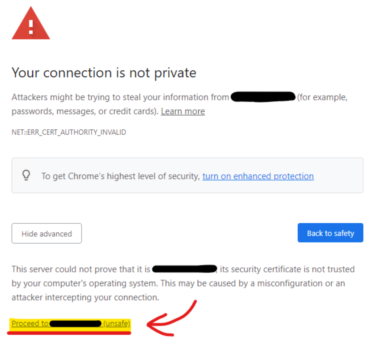

Hi @ECI
Editing is just to check your password.
Please note that the “connection not secure” dialogue is normal behavior.
You could just click on Proceed as highlighted in the screenshot below.
Additionally, you could create a new Wi-Fi network/WLAN, referring to the article shared in my previous post, and check how it works.
Let me know how it goes.
Hello. But I can’t get to the actual log in screen on ruckuswireless.com. It takes me through 2 screens and then I get to where it has an auto fill in with name: ruckus-wireless1 and asking for a password protect (wpa2) yes or no.  I have one for the initial login screen that I created years ago but never brought me to that screen.  Is this where I enter it? Or what am I setting a password for? It seems odd and do not want to proceed if not safe.
